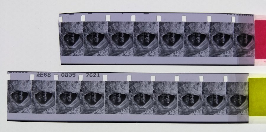

Very nice Beaulieu R16, checked/repaired/adjusted in 2018 by FilmKonsult in Sweden, purchased on Ebay. Used with Angenieux Retrofocus 10mm and a Som Berthiot 25 mm, both in perfect conditions. Light measured with a Sekonic during a steam locomotive passage, last Sunday. Filmed with Foma R100, processed using the bleach with the orange evil powder.
Is it possible that you get such disaster if the film loops in the camera are not long enough (= wrong camera loading)?
I bought a new spool of Kodak 7222 to make a new test.
Yes, film loading error can look like this. I would check out with a piece of old film in the light if the filmtransport looks steady when the loops have the right size

Concerning the loops, you must be very careful. In your video, the lower loop seems to move down during transport, so at lowest speed, the film must not touch the lower curved chrome plate ever. My R16 shows an upward movement of the lower loop, so a 2 mm distance to the plate is ok while threading. Maybe that the distance in your R16 must be more to avoid any contact, 2mm at the lowest point whlie running should be ok.

I recently obtained a couple of 7222 rolls and they turned out rather beautiful. Exposed at 250 ASA and developed in Orwo A71, I got perfect reversal results — sharp, fine grained and with incredible latitude, especially in the highlights. The stock is pretty soft though, so make sure to have contrasty light for best results. Flat overcast turns out rather boring, campfire reflections in kid's eyes/faces or bright sunlight turned out absolutely stunning. It's kinda the opposite of the Foma R in handling contrasts. Really beautiful stock, I still have eight 400' cans, would spare you a roll for Nairobi for free if you cover the postage, you'd still need to rewind it onto four 100' reels though.
