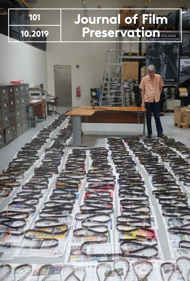

Ich musste an dieses Bild denken, das Cover des JOURNAL OF FILM PRESERVATION. Die Bildunterschrift ist...
"Erendur Sveinsson, director of the National Film Archive of Iceland, winding up the Russian Film Village Detective (1969), which had been caught from the bottom of the sea off the coast of Iceland in 2016 and brought to the film archive for inspection and preservation. There it was dried in a very primitive way while there were no film drying facilities at hand."
